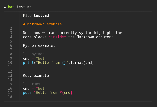

Syntax highlighting
bat supports syntax highlighting for a large number of programming and markup languages:
Syntax highlighting example

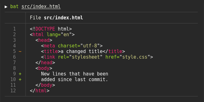

Git integration
bat communicates with git to show modifications with respect to the index (see left side bar):
Git integration example

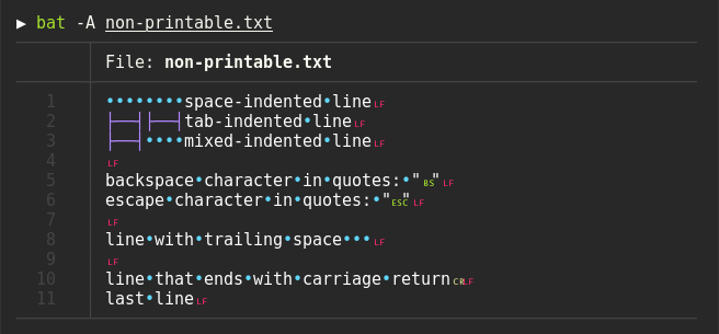

Show non-printable characters
You can use the -A/--show-all option to show and highlight non-printable characters:
Non-printable character example
